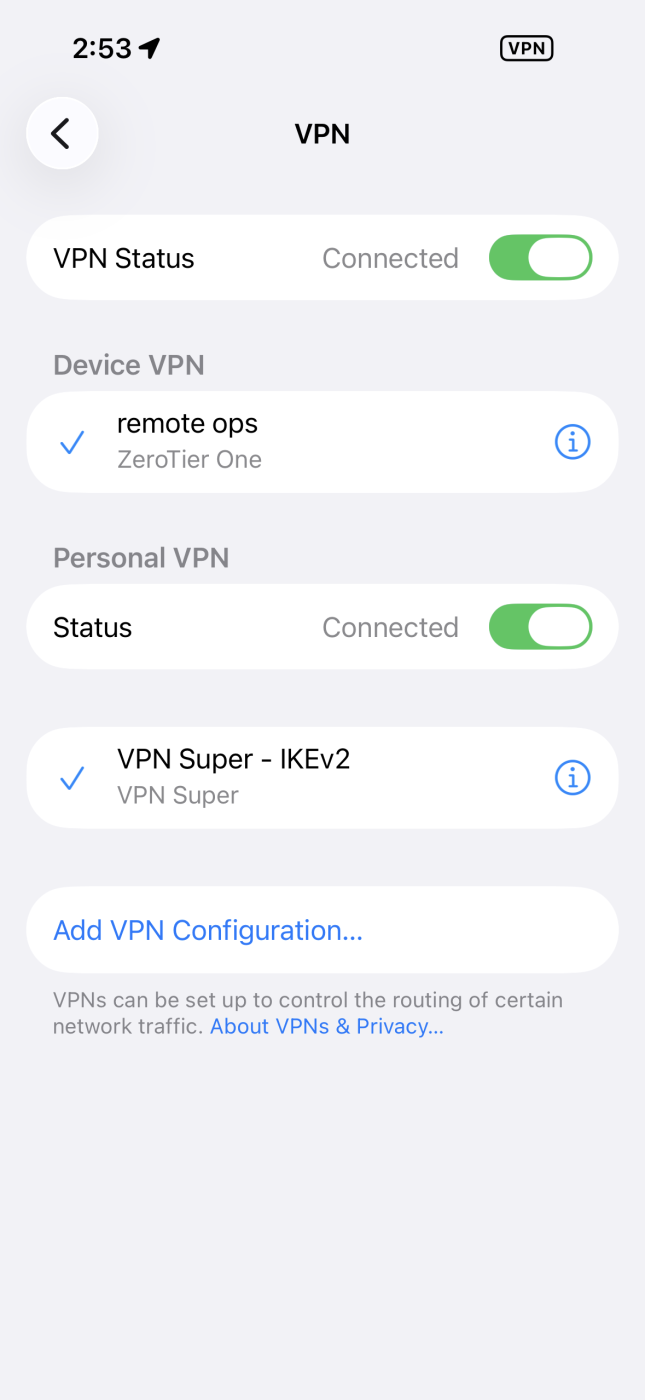

    I believe I have found a solution. VPN super. If I run it in conjunction with zerotier I am able to connect on 5G T mobile. Shoutout to David Peterson for his helpful post about this on FB

    How can you run two VPNs at the same time, ZeroTier and VPN Super … it seems not really possible. Is that really what you are doing? On what OS?

    I have been able to run both and it does work somehow. This is on iOS (iPhone and iPad). See attached photo

    I have to wonder if both are really working, generally that is a no-no. Have you ever tried say just vpn super by itself without trying to run zerotier simultaneously.

    yes of course. With vpn super only, the radio doesn’t even show up on the radio selection list. With zerotier only is shows up but does not connect
