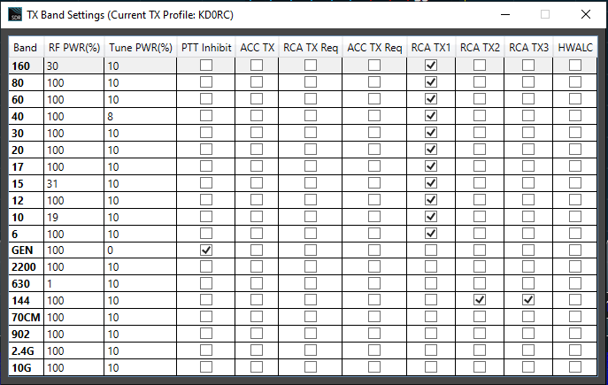

I want to use a contact closure output from my Flex 6600M to key an external amp on transmit. How to I set that up? I've tried using the TX1 and TX2 sockets but can't get them to work. Any suggestions?
Al, K0AD
Hi Al, TX1 TX2 or TX3 can be used. You then need use the TX Band Settings screen to select the RCA socket of choice for the bands that you will use. Here is what mine looks like:
I have a KPA 500 amp plugged into RCA TX1 that I can use on 160 - 6 meters. TX2 keys my 2 meter transverter and TX3 keys my 2 meter amp.
Len;
