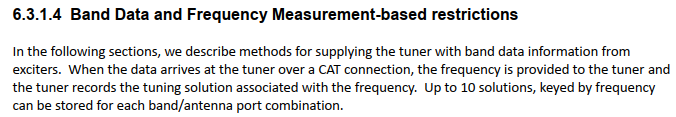

How many TGXL memories are there for each band/mode?
Are there 20 memories for each band and mode (e.g. band=40M / mode=CW)?
Hi David,
1x3 or SO2R model?
On the SO2R model it is 20 memories per band unless paired with the Antenna Genius. Then it is 20 memories per band, per antenna (up to 4 antennas per band).
I do not know if the 1x3 is 20 per band or 20 per band, per antenna. That would be a question for 4O3A. I have not tested the 1x3 TG.
73 Dave wo2x
Hi David, There are 20 memory slots per band and antenna. There are not memories per mode. I am not sure, but it might matter if you have a 1x3 vs an SO2R model.
Well that's confusing…
I think that documentation is not up to date. 20 memories per band and antenna port have been discussed for quite a while. You might want to send a note to 4O3A about it.
My setup:
I have an 8600M → PGXL → TGXL → AG → Hexbeam (10M → 20M inclusive) and a Vertical (10M → 80M inclusive).
From the comments above I understand that there only 20 memory slots by frequency for each band and antenna, and if I understand correctly, each antenna for every band has 20 memories. If I'm incorrect someone, please correct me.
David, K1MT
