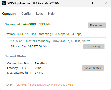

Beta Release v0.1.9b SDR-IQ-Streamer released
SDR-IQ-Streamer is an alternative for applications like SliceMaster and SDR bridge specifically focusing on the configuring and launching CW Skimmer with SmartSDR. This release is a self-contained executable for Windows 11 and Flexlib 4..1.5.
Try it and see if you like it. Supports multiple IQ channels and launches dedicated CW Skimmer instances with bidirectional Rig control including support for QSY and RIT tracking.
See project README for quick start instructions

    Dave WO2X - I did get a new version out quickly to support SmartSDR 4.2.x. I've got it running on two machines - one with v4.1.5 and the other at 4.2.18. Good luck and let me know how the set up and testing goes!
  • David Decoons, wo2x
    I did a quick test and CW Skimmer showed panadapter center frequency but the slice and smiler were in sync only when slice was in the center of the panadapter. I may be missing a setting.
    73 Dave wo2x

  • Chris WX7V
    Audio Device endpoint enumeration is still buggy so I'm working on a new design for the next beta release. I need to ensure the 4.1.5 DAX v1 support still works for MME and WDM, while also supporting the new enumeration model with DAX v2 for both MME and WDM. So 4 possible combinations to try and guess the right audio devices just for 1 stream. Then apply that from 1-4 streams!

    SmartStreamer4 v0.1.17b has been released this evening. Mostly bug fixes including a clean rewrite of the CW Skimmer sync path. Resolves the symptom where CW Skimmer needed a manual "jiggle" of the panadapter or slice frequency before it would start tracking after startup or band change.
    Also includes a new interactive Set Up Wizard to help accurately enumerate audio device end points (Config tab) and a revised Help Guide.
