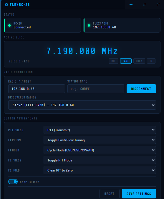

FlexRC-28 is a free Windows application that connects the Icom RC-28 USB encoder directly to SmartSDR.
What it does:
- Dial tuning with velocity-sensitive slow (10 Hz) and fast (100 Hz) step modes
- Automatic step snapping when switching between rates
- Snap to 1 kHz on panadapter click detects clicks vs mouse wheel automatically, so it only fires when you actually click to tune
- PTT momentary press-and-hold, or hold for 2.5 seconds to latch TX on; tap again to release. Great for ragchew where you don't want to hold the button the whole time
- F1/F2 buttons fully configurable by default: F1 cycles modes (LSB/USB/CW/AM), F2 cycles bands (160m through 6m) with automatic mode selection per band
- RIT control toggle, tune with the dial, display shows offset
- All four LEDs on the RC-28 working - Link goes solid green when connected, TX lights during transmit, F1/F2 reflect app state
- Connects to SmartSDR via the TCP API on port 4992 works alongside SmartSDR for Windows without interfering
- Radio auto-discovery finds your Flex on the local network automatically
- All button assignments configurable in the UI
