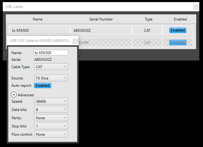

Hi Paul, there are two RS-232 connections to the KPA500. The one marked RS-232 (XCVR) connects to the USB port on the back of the radio. This connection provides band info to the amp from the radio using the Kenwood CAT command set (but does not use the CAT panel).
This cable needs to be defined in USB Cables:

The port on the amp labeled RS232(XCVR) should be plugged into one of the USB ports on the radio. Use USB Cables in SmartSDR to set this up
KPA500 menu settings:
RADIO - SERIAL RS232P - 38400 RS232X - whatever you have in USB Cables in SmartSDR SER POLL - ON
