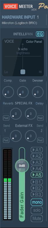

Klaus, thanks for the reply. This was helpful. I was not using the DAX so that solved a lot of my problems. The only issue I am having now is my audio is "warbly" like there is a reverb or delay turned on somewhere. I looked at all the places I know of and nothing is turned on that I can see. Do you have any suggestions for this?0
Scott,I assume that only the output who you using is active on the hardware input and that the monitor is disabled on the SmartSdr.Other possible causes:
- The microphone is assigned to an input in the Windows Sound Manager
- The gain is set too high in DAX
- The equalizer is set incorrectly in the Potato input
- Or the compressor, Special FX, or External FX is active in Potato
I can’t think of anything else right now
