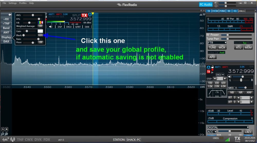

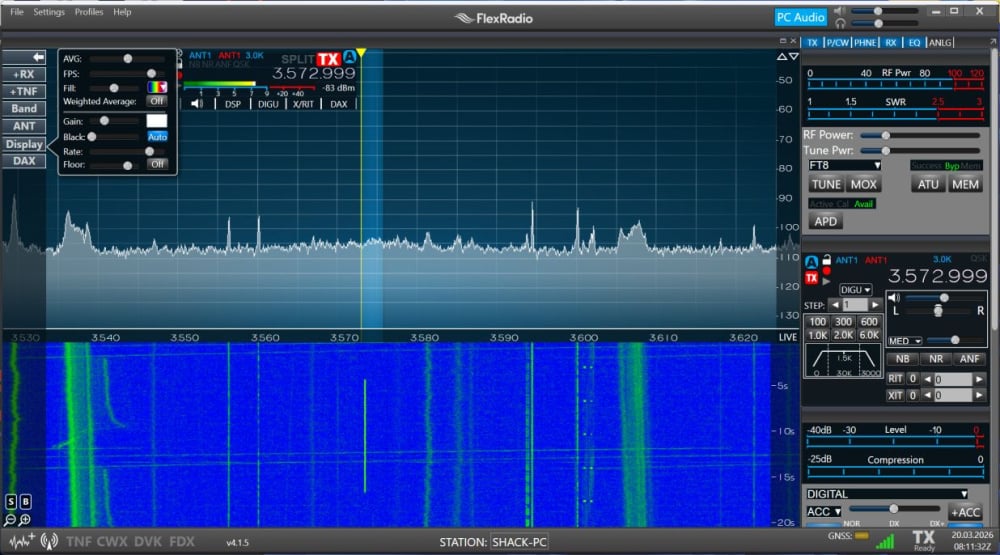

    Then you get this
    73 Klaus, DF3RP

    In SmartSdr, you may have moved the divider line too far down.
    In the "M" model screen, go to the display. Above “Floor,” you'll find a slider labeled “Auto”
    Click it, and your waterfall should reappear.
    73 Klaus

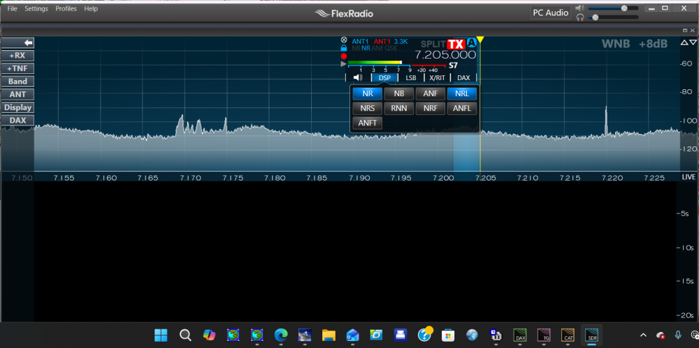

    Well darn. I minimized the SDR tonight to work on a net and other software logging same, when I went back to the radio the darned waterfall was gone again. yikes. I will try to send a pic if that helps.

    Ahhhh. putting it in AUTO did it. Tnx. Still wonder how/why it turned off.
