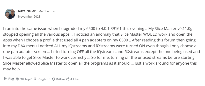

If you're getting the error message at the bottom of the window when you open Slicemaster, the fix is buried in the third page of an older thread with a title referring to SSDR version 3. I'm reposting it below for the benefit of those using SSDR version 4 who might be overlooking it. Just turn off any DAX IQ stream you aren't using.
