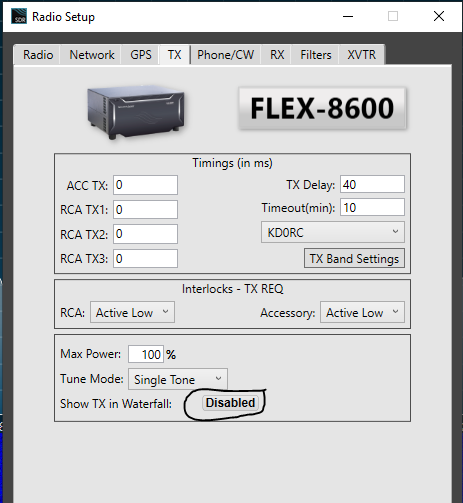

I don't know exactly when this started but when I TX CW instead of seeing the sig vertically in the waterfall it looks like a distorted sig (see pic).
Running PGXL, TGXL, 8600 SSDR 4.15 on windows 11.
Any ideas on what the cause may be? Happens at QRP, amp on or off, 400W, SWR 1.1.
Did a cold reboot, no change.
Thanks
Greg
AB7R
Hi Greg, it looks like you have Show TX in Waterfall Disabled.
Thanks Lee. That was it. :)
