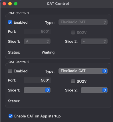

    I have iDigi working with SmartSDR for MacOS, it works well. Assuming both programs are running on the same Mac, all you have to do is make sure that the CAT settings are compatible in both apps. Here's a couple of screenshots to help.
    First I enabled CAT in SmartSDR for Mac:
    Note that I have the port number set to listen on 5001 and I have mapped the CAT control to slice A.

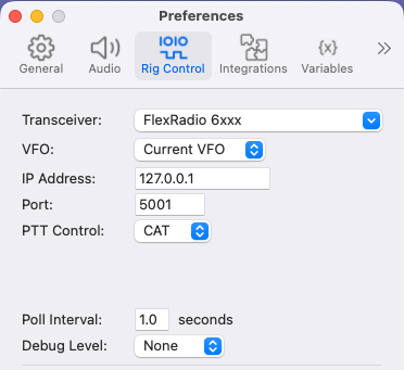

    Then in iDigi we can setup the CAT connection to the same port number:
    Don't worry that it says 6xxx (thats from HamLib I think), it works fine with the 8xxx series radios as well.

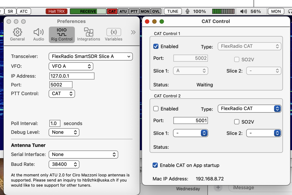

  • KD4UNX
    KD4UNX Member ✭✭
    I'm trying iDigi too, and seeing the same thing — I'm using SmartSDR on my Mac, and I have CAT control enabled on port 5002 (slice A). iDigi does not connect when configured for this.
    Note that the CAT indicator is red. CAT Control 1 is enabled on port 5002, and iDigi is configured for slice ! on port 5002.
    Anybody sort this out yet?
  • g4ivv
    g4ivv Member ✭✭
    Hello,
    Yes, you don't need to use CAT control in Mac SmartSDR (you can leave it disabled). In iDigi, the "FlexRadio SmartSDR Slice A" comes from the iDigi built-in HamLib library code to directly connect to your Flex radio.
    So, in the iDigi "Rig Control" settings you have shown, just make the following changes:
    • set the IP Address to that of your Flex radio, rather than the Mac local address 127.0.0.1
    • change the Port to the standard Flex API port of 4992.
    That should make it work - the rest of your settings are the same as mine.
    73, Jonathan
  • KD4UNX
    KD4UNX Member ✭✭
    Thanks - that fixed the CAT Control. Now to figure out how to use the app. :D
