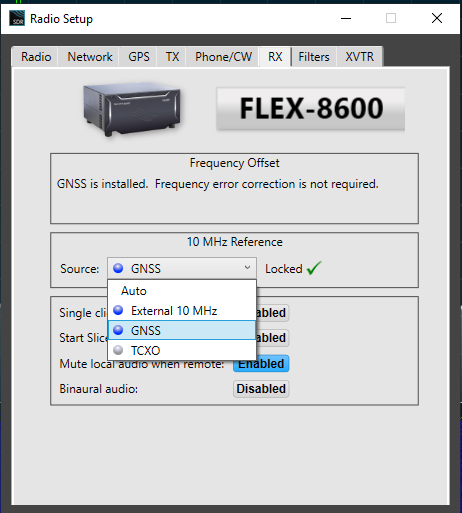

Which radio? SmartSDR?(Win? Mac?) or a Maestro?
This is 4.1.5 on my 8600 using SmartSDR for Windows. If I select External 10 MHz, it locks right up.

With the 6500/6700, Windows SSDR never was an explict option to enable an external reference. It has aways been connect the source and boot the radio. And the only way to verify is to run the self calibration against WWV. If its near zero, the external GPSDO is working. If the calibrated offset it a several hundred ppb, its running on the TCXO. Technology has progressed since the 6500 was designed almost 15 years ago.
