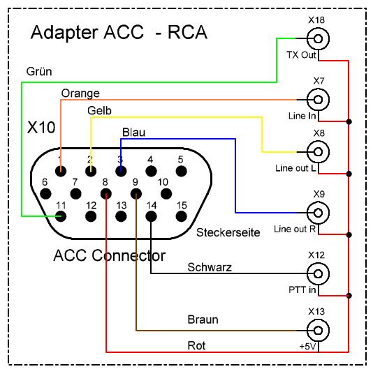

Hi,
I have connected my Rode microphone via the UR6QW equalizer to this connector on my 8600 and it works well.Since this is a line-in connector, I assume that a normal microphone signal will not be sufficient.
My connection ACC-adapter:
Thanks for the info. I've had two responses so far. The other was using the connector for a PACTOR modem.
Now, PACTOR is not my area of expertise.
But as far as I know about these modems, their audio signals operate in the range of 10 mV - 2 V p-p,
which corresponds to the Line I/O specification.Therefore, I think this port is exactly the right one.
Klaus DF3RP0
