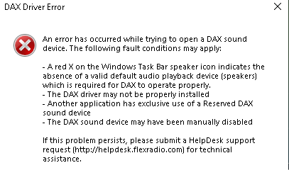

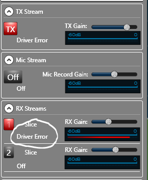

I'm experiencing a driver issue when I use WSJT on my 6400M. After upgrading to version 4.15, I encountered a pop-up window error whenever I tried to use WSJT in FT8 mode. Additionally, the DAX screen displays a "Driver Error" message on the RX stream. How can I fix this problem?
Thank you for your help.
Update: My issue is resolved. During my search, I found a document on reinstalling the DAX Drivers. After upgrading to V4.1.5, none of the drivers loaded, so I installed them manually and restored service. The process was straightforward. Makes me think there is a known bug with some upgrades. I hope this might help someone in the future.

Thanks, but don't think that is my situation. Everything worked until I upgraded. I cannot connect the DAX and receive a Driver Error on both TX and RX.
