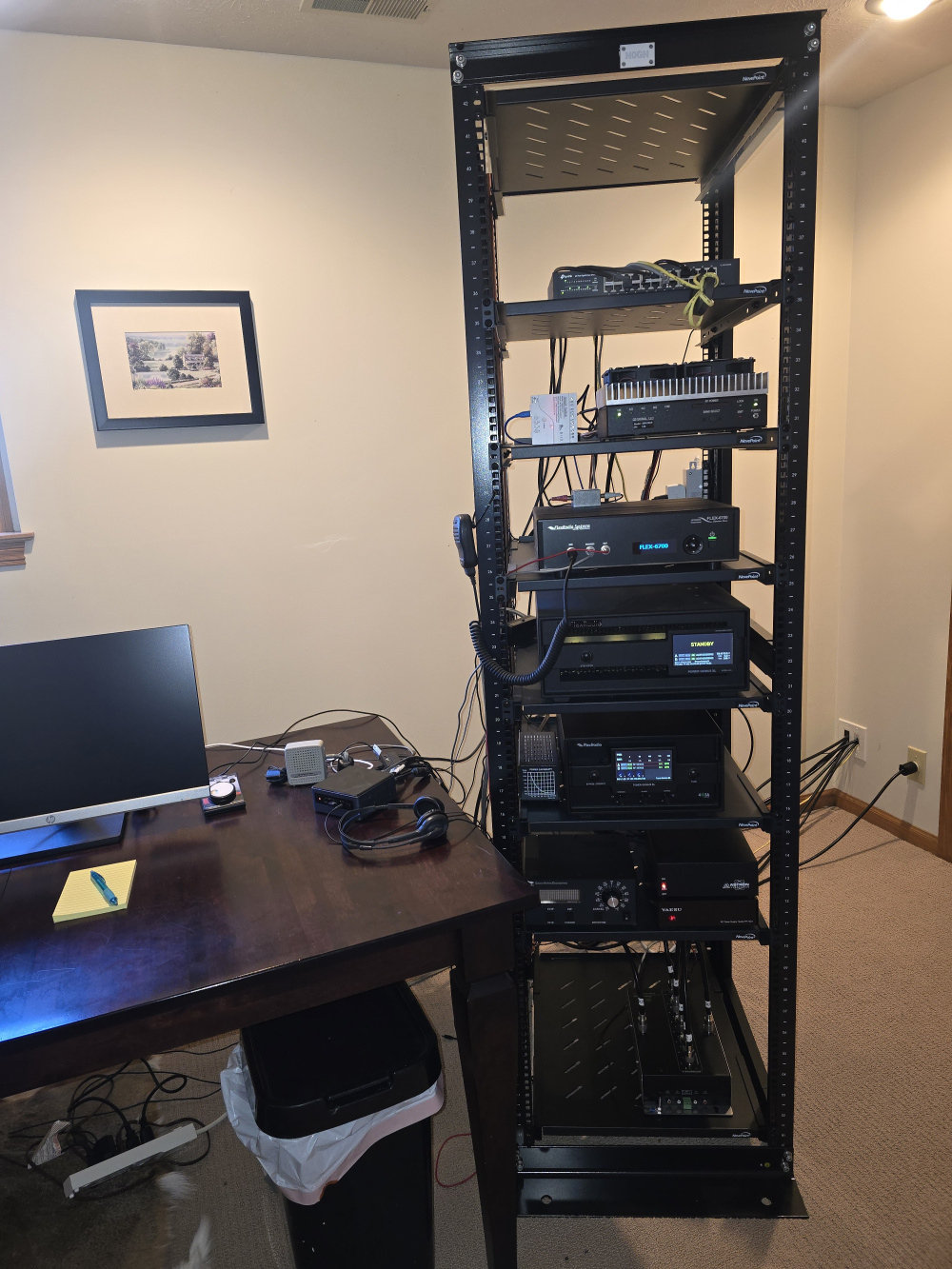

    You mean like the picture below?? No TGXL firmware 1.2's worked. Had to go down to 1.1.20. I got the switch you guys told me to get. I dialed everything down to 100MF. I have all Cat VIII. The specific move to "break it" is to upgrade the software… To summarize, with the upgrade, the specific issues are that TGXL crashes every 10 minutes in a contest, it doesn't hold it's tuning solutions, Maestro ATU button is erratic. It crashes when you use the VFO in a reasonable fashion. Frequent remote connection crashes. Probably other things I'm not remembering now. I feel like I've been kind of ghosted on this since it doesn't affect all users. Maybe only a few? As far as I know my Helpdesk ticket is still open and last I heard they "sent it to engineering". I'm kind of tired of waiting. Are you telling me I have to get an 8400? Or is it possible my TGXL is a lemon? The TG, PG, and AG are all relatively new.

    what else do you have connected to the radio?
    Software - logging? FRStack? Other?
    Hardware / to troubleshoot start with radio, Maestro and TG to a switch. No Internet, no PC. Minimize any network traffic for testing.
    What version Maestro? What model Flex? (I am assuming a 6000 series).
    What is the voltage to TG. 4O3A recommends 15 VDC minimum. I have seen issues with less than 14.5.
    The Dream Station configuration pdf has very good step by step process for introducing each piece of equipment.
    Last, have you tested into a dummy load to rule out RF getting into network?
    The big change with 1.2.17 is introduction of metering and control of TG into SmartSDR and Maestro which means more IP traffic to & from the radio.
    sorry for all the questions but trying to understand what is different on your particular installation.
