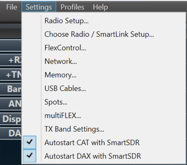

I dont find any way to let the CAT start after launching the SSDR program.
Phil
Are these boxes checked?
Mike-VA3MW Administrator, FlexRadio Employee, Community Manager, Super Elmer, Moderator adminOptionsThis has been reported as a problem and engineering is aware of it.
The workaround today is to turn off CAT Autostart and manually start it.
