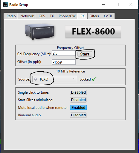

My only other nit is the GNSS. It seems kind of useless and I'd like to be able to turn it off in the software. My rig is not near a window and my computer time is very accurate with Meinberg NPT. I believe someone has submitted a feature request for a software turn off.

The GNSS is primarily for frequency accuracy, not time. You can turn it off and use the internal TCXO without the GNSS discipline. If you select TCXO, be sure to do a frequency calibration - click the Start button in the Frequency Offset section after selecting the appropriate WWV signal for your area. I live 50 miles from WWV in Ft. Collins, so 2.5 MHz is normally best for me. Use the one based on where you are and the time of day.
Wow. That was simple. Thanks!0
