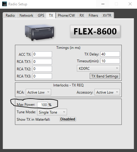

It is probably your Max Power setting. Go to Settings, Radio Setup…, TX tab and check your Max Power.

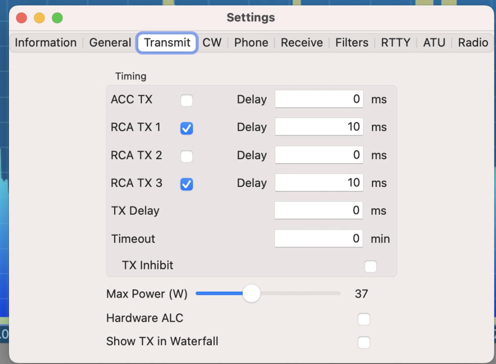

Thank you for your reply, although your screenshot was for Windows it sent me off to look for similar on the Mac version, found it as per screenshot, now how/why did I move that!
I appreciate your help, thanks
