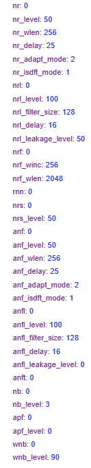

Not sure what the timeline is for any API documentation update for v4. For all I know it could be out there. For those wanting to play with the API and adjust the new DSP and ESC features in v4 see below, I captured these from a slice open on my 8600.

    That is great to see. I have wondered if they would expose the different settings for the DSP functions in the API. From another thread and a quote from Tim, version 4.2.x will have an added control panel to allow users the ability to adjust several settings for the DSP functions. I had suggested this to Steve Hicks and he passed it along to the development team. And it looks like they are going to add it after all. I also suggested a Reset to default settings button in case the user got too far out in the weeds adjusting the different settings.

    I've been doing that too. For my app you left click to enable DSP feature and right click to open up adjustments.
