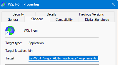

    Geoff,
    If you use the WSJT '—rig_name=****' option, then each unique rig_name has its own WSJT log directory
    including .ini file.
    Works for me.
