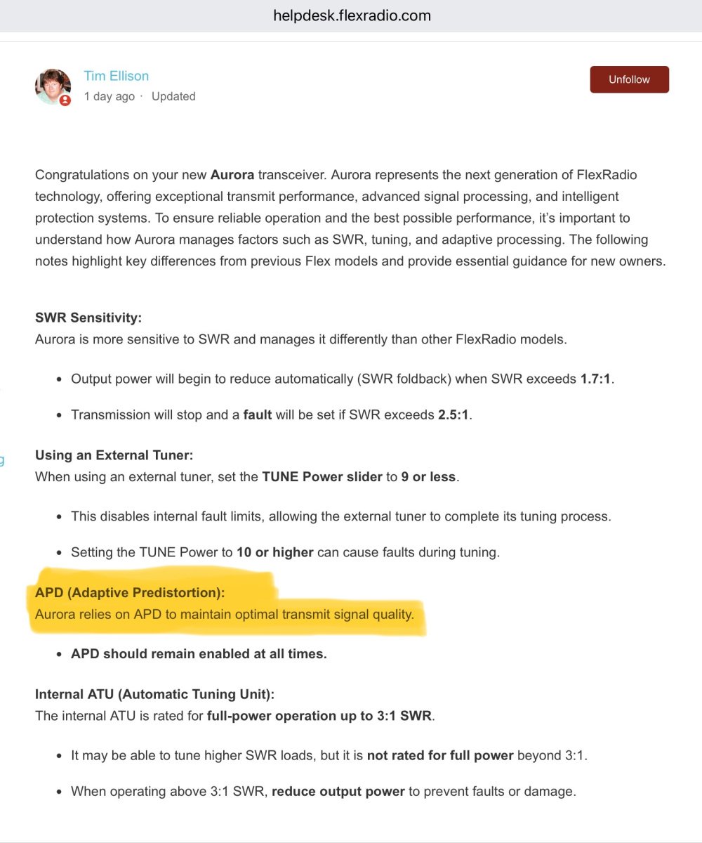

Aurora - APD should remain enabled at all times?
I saw this post yesterday and the part about APD being enabled at all times was confusing - if something needs to be enabled at all times, why give the user the choice of disabling it the new Aurora?

Polar modulation needs APD to have low IMD on the transmit signal. Since SmartSDR works with both 8000 series and Aurora, the button is shown.

Is polar modulation used beginning at one watt tx , or does polar modulation, for example, turn on at 100 watts tx? I guess my question is why is there a choice for APD on/off if it is always required to transmit? It should just be grayed out on the Aurora in that case.
