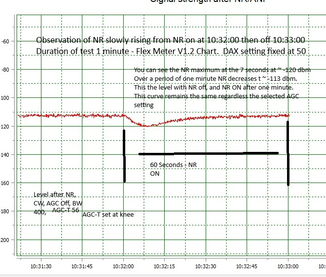

Thank you. I've been trying to quantify some of the performance numbers. My test this run was to use FlexMeter to report audio noise with NR ON and OFF.
NR does work with is setup………but as you can see over a period of one minute the noise level returns to before I turned NR ON. NR is on over the entire one minute. No changes to anything during the test.
I do consider the possibility that my test is faulty, but I've run it many times this morning with the same result. Read the notes on the chart.
I don't feel satisfied with the results so I will continue using a different method.
