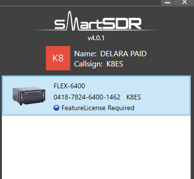

Upgrade from V2.12.0 to v4.0.1 and won't run. "FeatureLicense Required"
I upgraded from a version 2 to 4.0.1 and I understand that v3 features won't be available but now I get nothing but the Smartlink radio choser page with FeartureLicense Required" displayed.
I understand that I don't get the v3 features but now I get no radio at all.

    Here's an update on things tried today
    - I was trying to upgrade my 6400 from version 2.12 to 4.01
    - Previously running fine on Version 2.12
    - I received the "FeatureLicense Required" message when I started SmartSDR 4.01
    - I was unable to advance to the panadapter display
    - I tried to set up SmartLink but received the red dot when testing communication with SmartLink
    - I did a factory reset on my 6400 as per manual (including holding power button down, powering off, waiting etc)
    - No change to results when starting SmartSDR 4.01
    - No change when testing SmartLink. Red dot still appears
    - Reverted to Version 2.12 (including radio firmware update/downgrade). Works fine with version 2.12

    Hi Guy's I'm also having the same problem as some of you, I've got a Help Ticket in and Flex Tech's are helping with my problem and it's not sorted at the moment, I've got a Flex 6300 was on Version 2.12.1 so upgrading to version 4.0.1 NO GO I've done a Videio because it would take me toooo long to explain what I've done so far, Flex has upgraded my 6300 to V3 on my Flex License from a V2 and it did't help the fix so still working with the Tech team to get it sorted, I've done the video on my phone so sorry for the movement hi hi 73's LZ2AOV
    Hi Robert, with 4.0.1 loaded on your Flex, export your profiles, then do a factory reset. I think that will solve the issue.
  • M0AOV
    M0AOV Member ✭✭
    Thanks Len
    Did the Factory Reset and all is working now, Thanks to the Guy's at the ticket System as well.
    So to anyone else who has the same problem as me submit a Ticket and ask for your License to be put up to Version 3 then do the software in stall ten do a Reset and hopefully is should be working on Version 4.0.1
