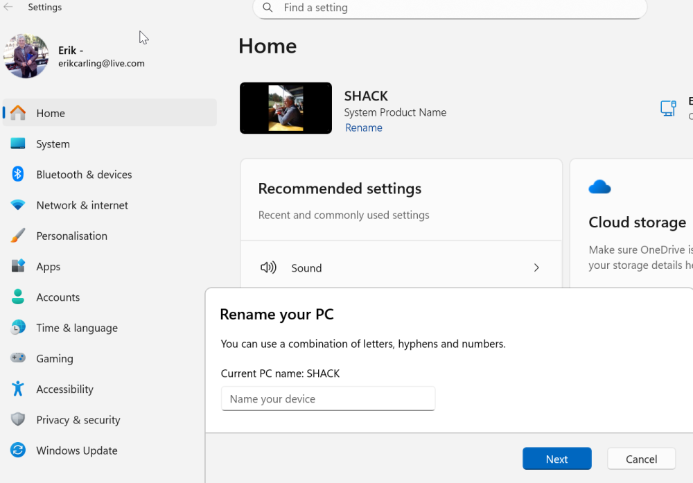

Where are you entering your call, Mark, that gave you no problem before but does now? This leads me to believe that I am mistaken so forgive me if this is bad info:
This is where I set my computer name which is what is displayed in SmartSDR.

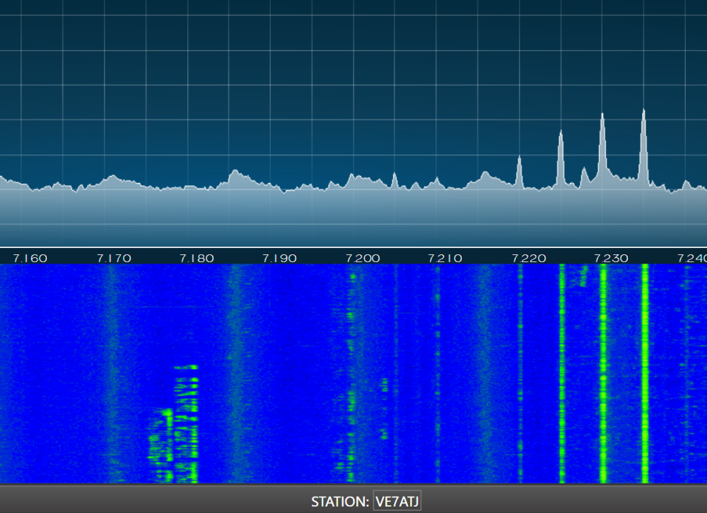

Hi Mark… if you mean the station id @ the bottom of the panadapter, here
Then it's just a type-over field. HOWEVER, as I found out, you need to press ENTER after you put in the new call sign. Then it should hold for the next startup.
