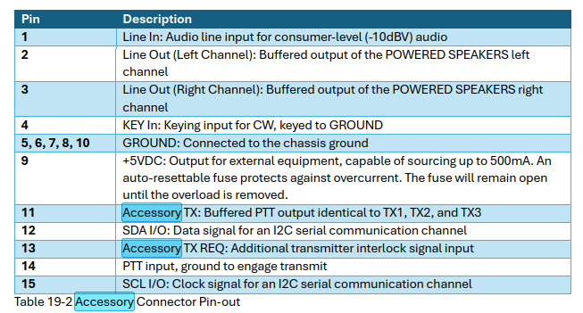

"In CW mode, the Key input on the FLEX-6000 rear panel accessory connector (pin 4) can be used as a straight key input. "
OK so a de15 connector to pin 4 and a ground on the TRS jack? I have K1EL keyer I would like to use.
Best Answers
You can find a ground on the accessory connector:
Thanks Geoff, appreciate the clarification. pin 4 key and either 5,6,7,8,10 for the ground.0
