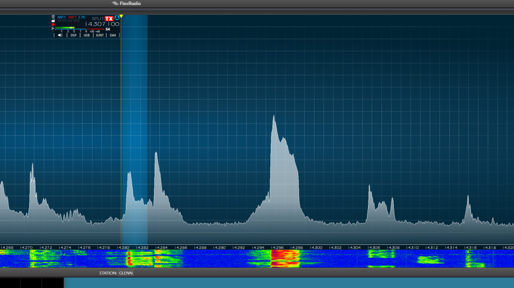

If you look at the image. Take note of the frequency. Then look at the waterfall. The Visual indications of the pass band DO NOT match up with the frequency being displayed and listened to. Appears the SDR Slice screen freezes. I tried to make another and it sounds like there is one but none visible. I also had the entire receiver disappear and not able to make a new one appear at all. I shut down the software and when restarted it put me on a previous frequency.
When I did the install I did follow the install directions. I also gave it more time than listed in every step. So not an install problem or error on my part. Also not a slow computer or ram issue as I have 128G ram. I have found issues with the last several SDR Installers ever since the 8000 series was added. I would bet there are differences that are creating these problems I have begun to have ever since.

This is an interesting one. Is this something you can reproduce?
@Glenn Depp Looks to me like they do. I see different EQ settings, but nothing else.
