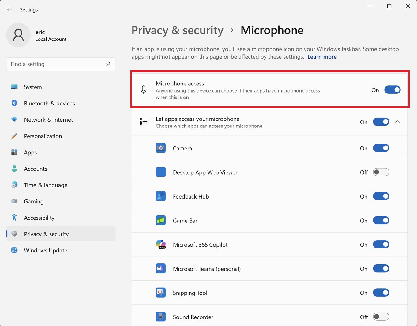

I worked with Fred and we got DAX working. In addition to the Core Isolation settings, we had to adjust the Microphone Privacy settings (see image below) in order to get the TX side going. Once we did that, DAX stopped complaining.
Hmmmm… interesting. Never seen THAT come up before. Will have to watch for that.
Thanks Eric!
Eric did a great job finding and fixing the problem I had with Windows 11 causing DAX to not work. Don't ya just luv Windoze 11? Can't wait to see Windoze 12! NOT
