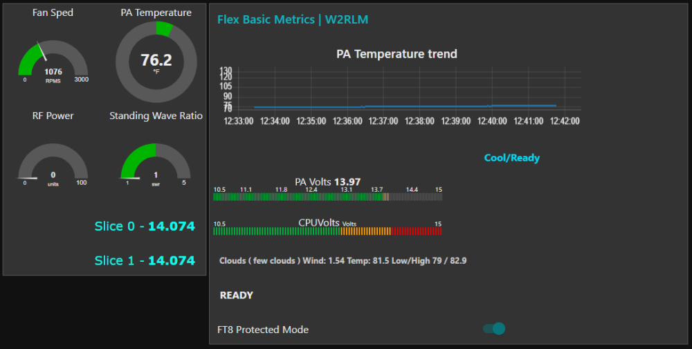

I track my power with the Alinco 13.8 with only the Flex Connected, and internally with my mini node red that I built, again everything looks healthy there.
