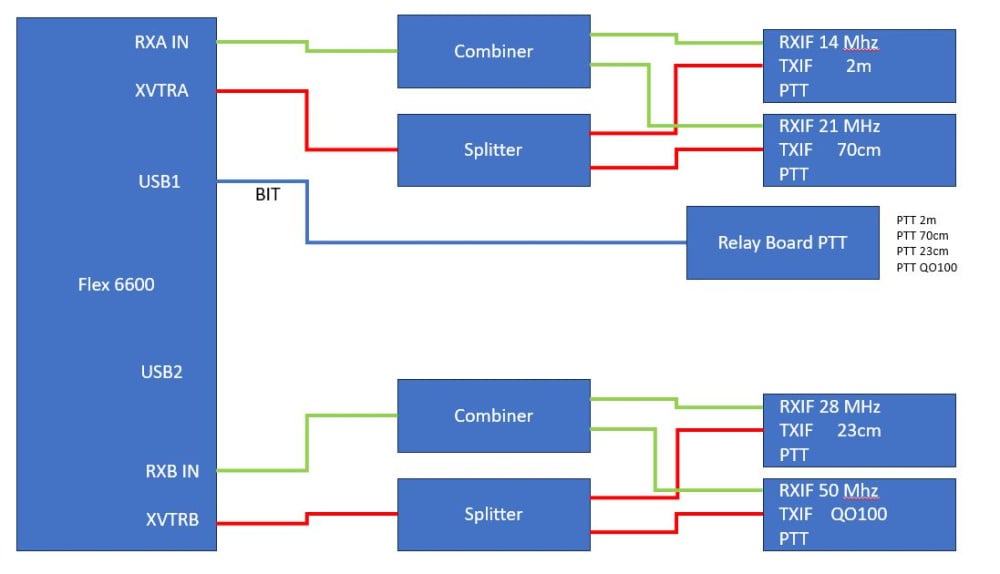

Hello,
I just received from Q5 (Corey) my 2m (IF14MHz), 70cm (IF21MHz) and my 23cm (IF28Mhz) transverter. Now I have to integrate them in my setup including a QO100 ground station from DX-patrol.
I was thinking about using two combiners for the RX?! Does anyone has done this?! is there any reason why this should not work?! Or do I have to use two relays to switch between the two transverter in RXA and RXB line?!
Thanks for any help!
