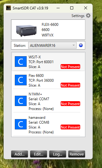

Ok folks I have reached the 'pulling my hair out' phase with this issue. SmartSDR CAT is showing all of my ports as 'Not Present' (see attached screen shot). I have tried everything including completely uninstalling and reinstalling Smart SDR.

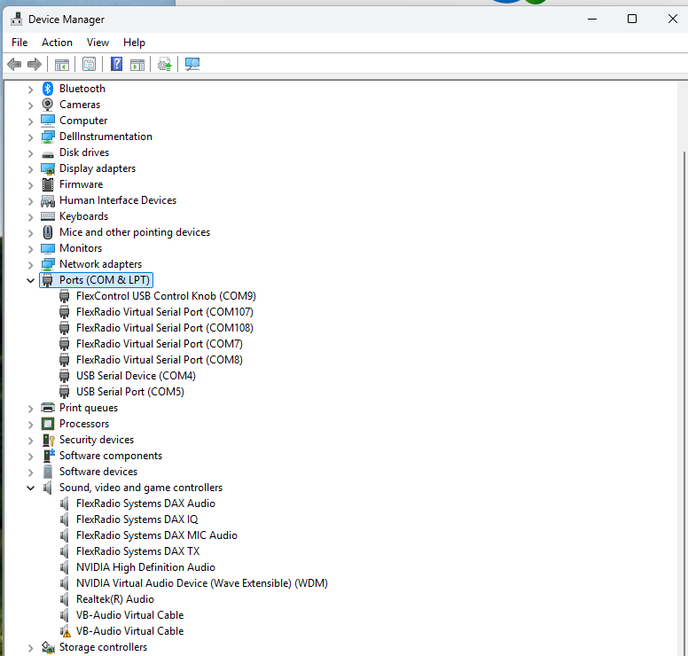

I'm running windows 11 and am fully up to date. Running latest version of SmartSDR. When looking at the device manager COM ports are present and report as working properly(see attached screen shot)

Update: I again uninstalled SmartSDR and also uninstalled FlexVSP. Reinstalled everything. SmartSDR CAT seems to install two ports by default. COM8 tied to Slice A and a TCP port 5002. Both are reporting as 'Not Present' in SmartSDR CAT.

Ok, I figured a workaround. If I explicitly pick a profile after starting up SmartSDR, the ports magically become present
"Not present" is reporting that the related slice (A,B,C,etc.) is not present ( not running ) in SSDR. Therefor nothing for the CAT port to work with.
And you found a solution for creating a Slice. I am surprised that there was not a slice running when your first started SSDR.
