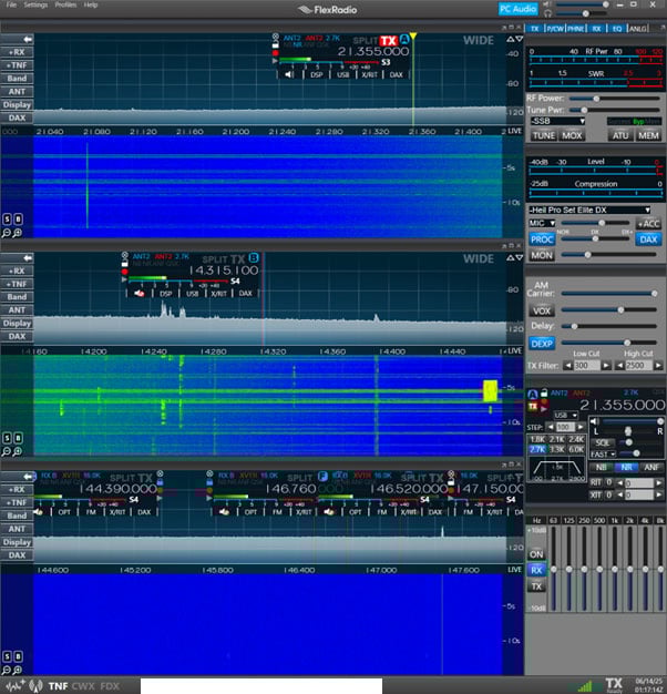

After updating without apparent issue my 6700 and Maestro "A" from v3.8.23 (was mostly running fine as far as I noticed) to V3.9.18, the SmartSDR seemed to work fine. My usual 3 panadapters and six slices were open and working. I primarily use SmartControl to operate Slice A (on the Maestro Slice B is muted)

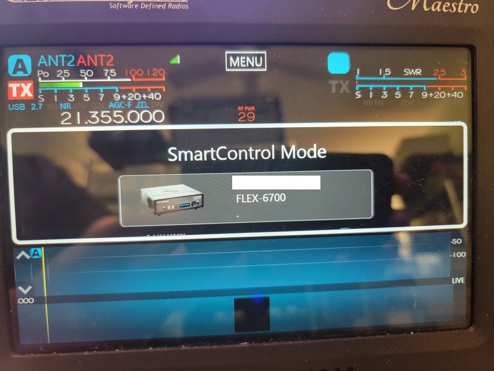

However, starting up my Maestro (after the same update) in SmartControl mode causes SmartSDR to close one of the panadapters with several slices—leaving only two panadapters in SmartSDR. Also, Maestro screen in SmartControl mode now looks different: There now seems to be a dormant spectrum display (or waterfall?) at the bottom of the screen. (photo) Is that intentional?

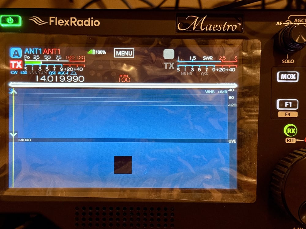

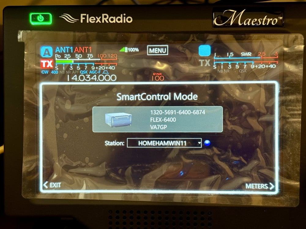

I use SmartControl, and just a single Panadapter (one slice). Usually I expect, and get:
But with 3.9.18 I sometimes get this (after some idle-ness???):
It does seem to self-fix if I change bands or something, then come back to 20m. I never experienced this with prior versions of SmartSDR.
I haven't thoroughly checked the circumstances when this occurs; rather, I've quickly focussed on getting a working solution. So my characterization of the circumstances is poor…
I opened a ticket and this was acknowledged as a known software defect. I use global profiles and if you switch profiles and switch back the display anomaly can reset to normal. Hope they fix this soon!
