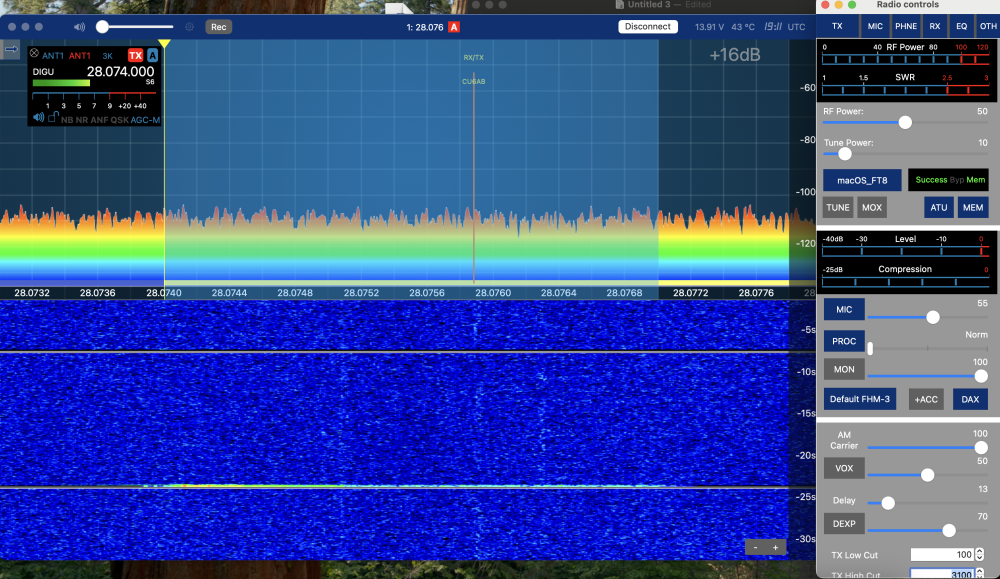

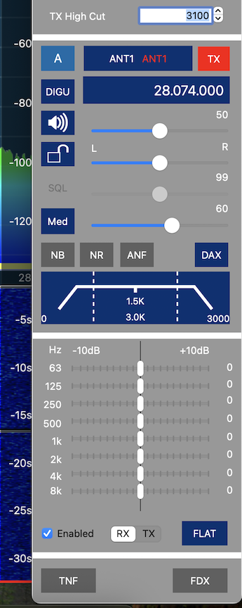

Not sure if I have something dialed incorrectly or another issue going on.
When using FT8 within SMARTSDR the radio pulsates and the amp output on power supply bounces all over for a bit on Tx. I have attached a video link to show what it's doing and screenshots of my settings.
I am sure I may just have something wrong or missing something. This only does this using FT8.

video of macssdr screen during transmit would help debug
would be good to see voltage reading during transmit as seen by macssdr
as seen on upper right part of macsssr screen

Thanks for suggestions ,It just happened to be turned there when I did video but I have tried non-multiflex so the front panel is doing nothing, I have also tried having in 40m and same issue either way.
Voltage stays consistent even on Tx. Here is link to screen recording during Tx.
Also, I have tried from Windows with the same result, needle bouncing (only FT8) and waterfall pulsing.
I just started to use the FT8 and everything else is fine. Kind of makes me think it could be a setting within the 6400m itself since it happens on MAC or Windows version. Voltage stays at 13.8 from both when Tx.
Only other thing that happened recently was radio lost power on boot and was at a Windows restore screen until I rebooted and came back fine.
