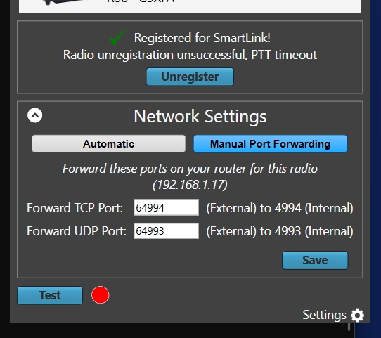

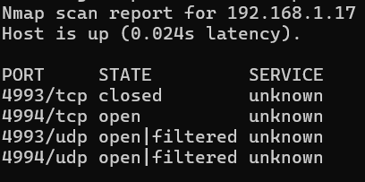

I am trying to use smartSDR and a Flex-8400 on non standard ports. Even though I have set them in the smartSDR software (and pressed save) the test has still been failing. I've done an nmap scan of the radio and it shows it is still listening on the default ports.

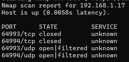

Even more weirdly, if I try to connect from a computer off site (different internet connection) it shows the correct external IP address and the changed ports, but connecting fails.

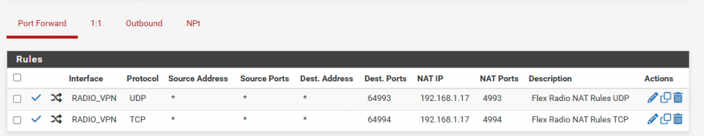

    edited March 2025 Answer ✓
    Ah so I need to do port translation within pfsense to make it 64994 —> 4994? Will give that a try!
    Something like

    I might be wrong, and I don’t have the documentation available right now, but I suspect those ports are for SmartSDR configuration, not the radio itself.
    What I mean is that if you want to change the NAT mapping on your router (e.g., internal port 4993 routed to external port 64493), SmartSDR needs to be aware of that. This should be handled through its configuration window.

    Isnt that what I am doing in the first screenshot?
    From a remote client it knows about the updates ports when I hover over the radio in the SmartSDR software but it will fail to connect.
    It looks like unless the test passes locally, the radios ports aren't actually changed?

    Len is correct. The radio uses 4993 and 4994. The setup screen in SmartSDR is where you define your external ports then in port forwarding in your router you set 74994 external to 4994 internal to IP of radio and TCP.
    Then 64993 external to 4993 internal to IP of radio and IDP protocol.
    Once that is done de-register and then register the radio. This tells the server which ports and the server sees you WAN IP so it knows how to reach the radio.

    since you have set up the proper VPN and see 64994 & 64993 open from the outside, try the de-register, re-register (requires local PTT).
