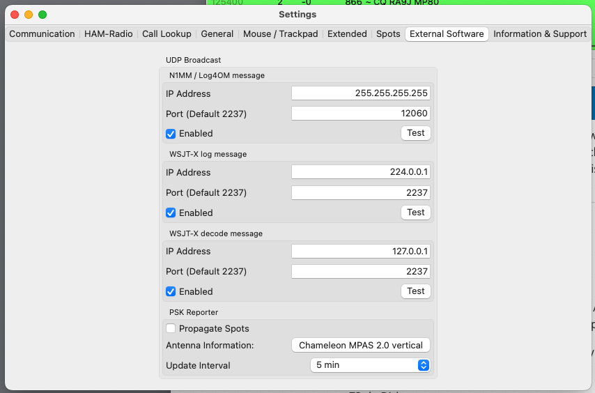

Hi all,
I just started SSDR for Mac and there was a note that this new version 2.9.55 IS ABLE to send messages via UDP to f.e. Gridtracker :-). In the settings tab there is a new tab: External Software in which we can fill to ports. Unfortunately I didn't get it working yet, but If someone else know how to fix to: please let us know….
As they say "timing is everything".
Not 24 hours after I received the discount code and purchase loopback….. and BEFORE I had even installed it…Marcus released a new version that drives what I need directly by UDP. (it works exactly as it should…. DIrk, try 127.0.0.1 for the IP.)
Dirk . . in case you missed my tacked on comment.
Try 127.0.0.1 for the IP on the decode message. Verify that gridtracker is using 2237, match bearings and shoot.

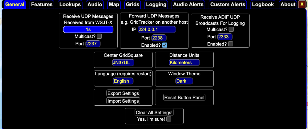

Hi Rick,
Sorry for my late reply on your question, but here is my answer:
I don't use WSJT-X and loopback: it's now possible to send data direct from SSDR (for Mac) to Gridtracker, without using wsjtx-x. BUT, you cannot click on the call roster in GT to transmit. So I look in the Callroster which stations I need, and then click on this station in the SSDR FT8 tool :-)
These are the settings in ssd for Mac
Settings in Gridtracker
Settings in Maclogger DX
NOTE: you have to startup in this sequence: 1) SSDR for MAC 2) Gridtracker and 3) MacloggerDX
Succes,
Dirk HB9GPN
