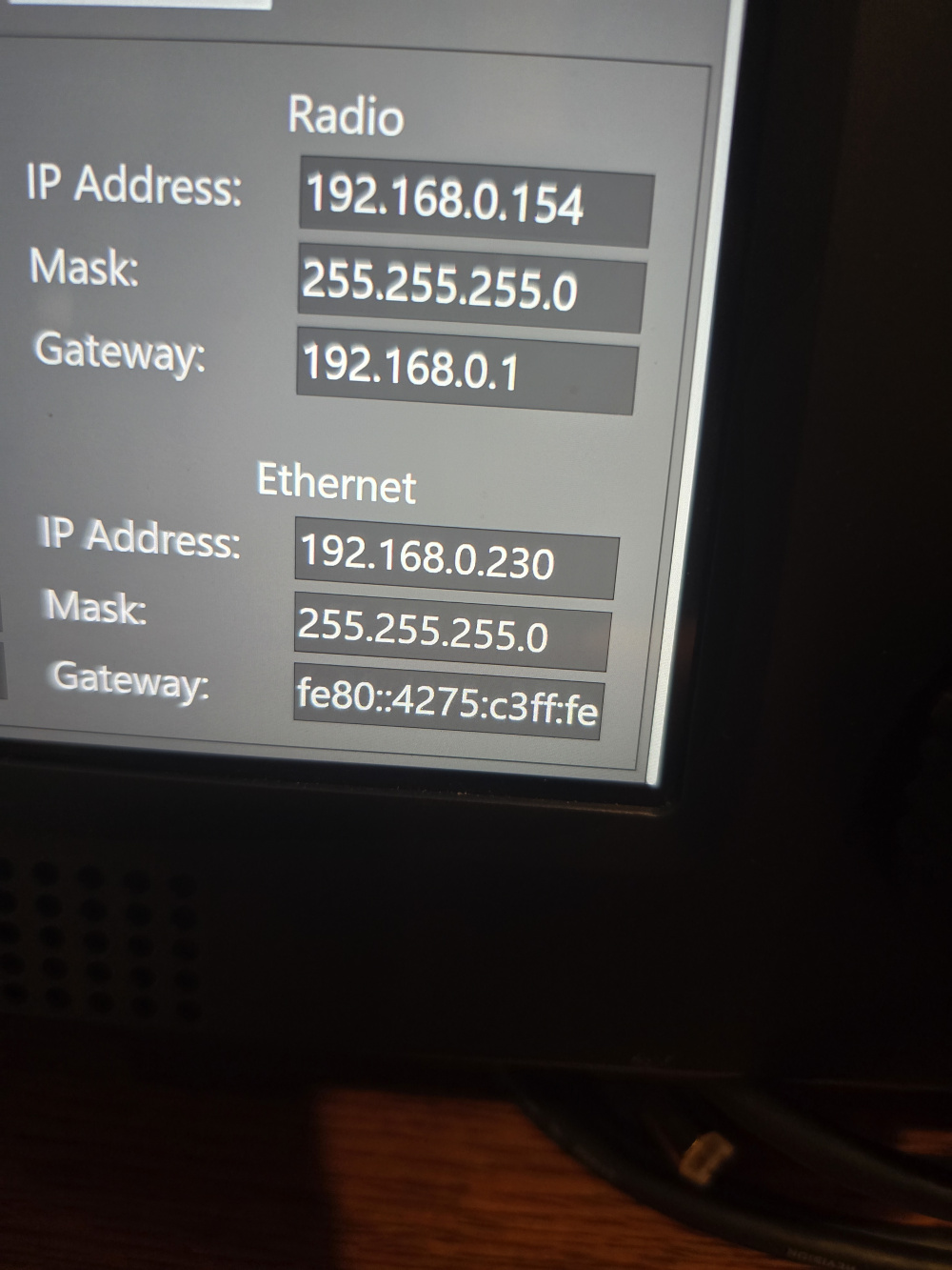

Hi all
I did the update to SmartSDR 4.1.3. And the IP address section of the radio changed the Gateway to some garbage, see picture one
I shut the radio down and disonnected the Ethernet cable and set the Gateway to 192.168.0.1(which is correct) the other Radio and Ethernet information is correct. Then I did a power off and reconected the thernet after the radio started and the Gateway for the Ethernet changed back to the garbage.

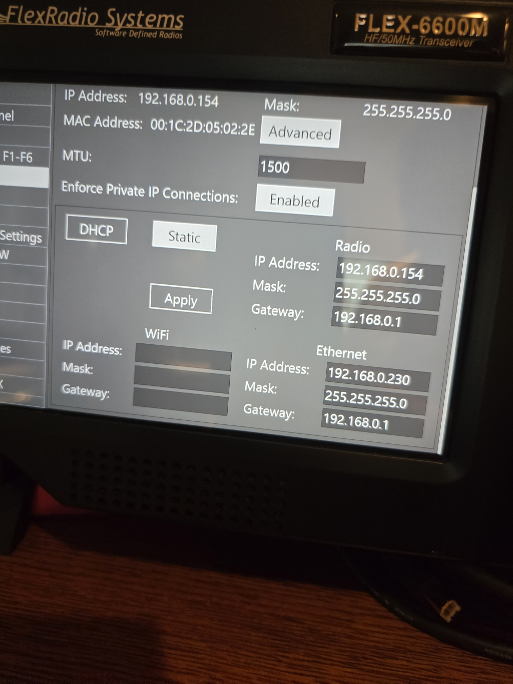

Picture after change to 192.1680.0. I have a cox wife router and wirelss mesh network with port fowarding to 192.168.0.230. It has worked in the past, Why does the Gateway keep changing? Any guesses?
