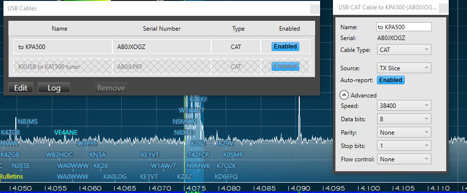

    Well, I just opened WSJT-X and my KPA 500 and the FlexiCraft Utility follow the band properly when I click the band change in WSJT-X. It also follows correctly if I type a frequency on another band in the flag of SmartSDR.
    I have an 8600 running 4.2.20. I have both amp serial ports plugged in - The RS232 (PC) port is plugged into my PC and is what the FlexiCraft Utility uses. The RS232 (XCVR) port is plugged into the back of the Flex which tells the amp directly what band I am on. If you don't have this cable plugged in, I suspect that is your issue. If you do have the XCVR cable plugged into your Flex and it is set up like I show below, let me know and I will look further.
    Here is how I have my USB Cables set up:
