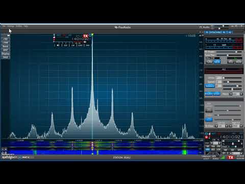

For me looks good on my 6700 with 3.0.27
https://m.youtube.com/watch?v=Du5UdmCsC5k 0 -
