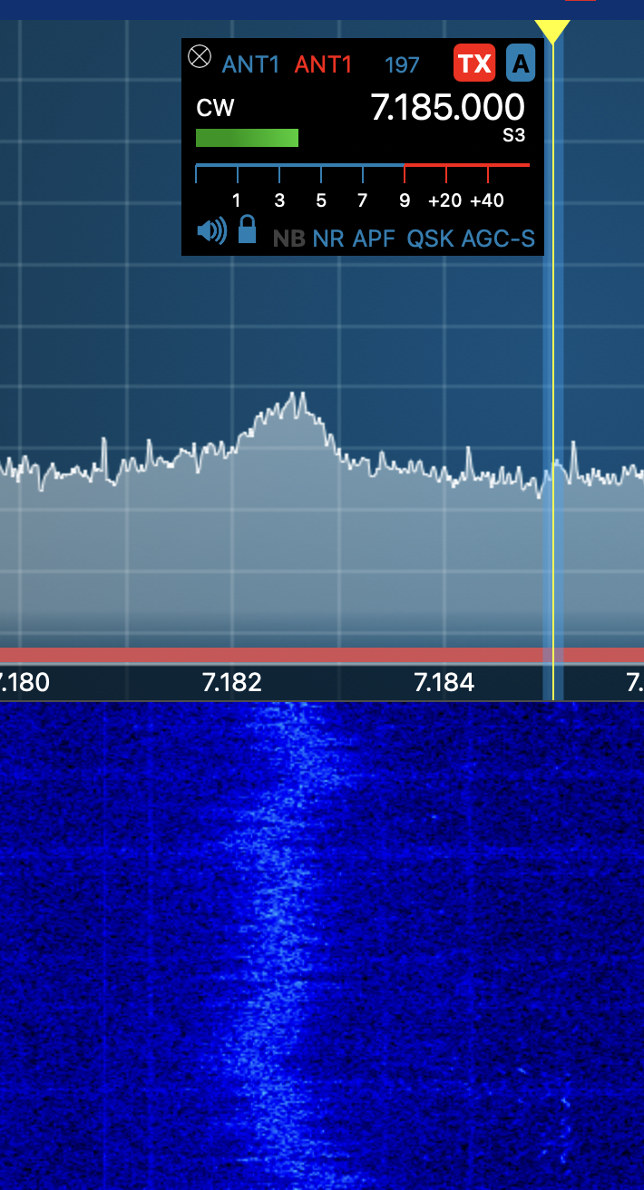

Can anybody tell me what this alien signal is. Always present as shown here, wanders back and forth around 7183. Real pain because several nets use this freq. It is a whistling sound and like wind blowing. Cannot ameliorate with NR, bandpass changes, etc. It is very annoying and sometimes as strong as S7. Thanks.,
Hi James, that is likely a switching power supply in your location, or perhaps at a neighbor's house. Try unplugging wall-warts, TV sets, laptop power supplies, etc to see if you can isolate the piece of equipment causing the issue. Note that simply turning things off usually has no effect, they need to be physically unplugged.
Once you identify the culprit, ferrites on the power and other cabling might help, and might not. It depends on the mechanism that the RF is using to get into your radio. If it is direct radiation from the device, there is not usually much that you can do. If it is radiating from a power or other cable, mix 31 ferrite beads often help.
