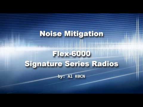

Ok I hope FRS has Al K0CN on their payroll because his latest YouTube video is really awesome. I thought I knew what all the filters did and how to adjust them but after watching Al's video it now makes a lot more sense. So my tin foil hat is off to you Al. 73
https://www.youtube.com/watch?v=Qqtj8CS_UE4

    I was thinking about making a video tutorial about these exact controls. I guess I can mark it off my list. K0CN has done a better job than I would have done on this one! Well done!

    Al's K0CN video on noise mitigation uses a red line to imply the Wideband noise control.  It would be wonderful if that red line is incorporated into the  SSDR package.  The guess work would be supplemented with a visual indication on where the level is set. Could it be turned on and off if possible?
