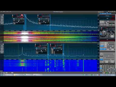

    My neighbor on CW on 18 Mhz less than 850 yards from my antennas. He is using a Tokyo Hy Power and blasting CW at +500 watts.
    No saturation on the front end of the radio. The second panadapter is listening to 17m on phone.
    https://www.youtube.com/watch?v=VrXjmoXJcA0
