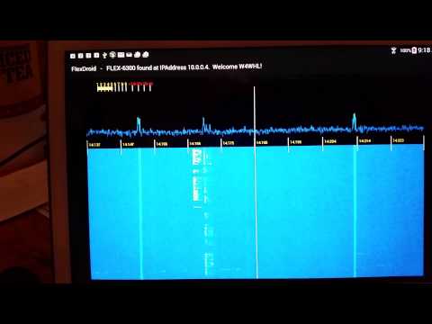

William, I thought you'd like to see. This was a test I did awhile back. Now I know how to upload, I thought you'd like to see this. It was a very static filled night.
https://www.youtube.com/watch?v=skxUt866pGo
Nice0
It looks similar to one of my java test on the PC. Thanks for the metering code snippet in the other thread. I see now that each 32 bit word is made up of a 16bit meter ID and a 16 bit value.
My biggest hurdle is finding what I need in the API code. Not being a programmer, its hard for me to find this stuff. But once shown I learn quick. I'm having fun with it.
William
Very nice, Walt. William, have you considered using just one dot on the panadapter trace instead of a whole bar? Would it save any processing juice? I actually prefer the line trace rather than the whole "filled under the trace" way. But I'm aware that people are pretty passionate about their preferences in this matter. Ha.0
At the end of the day WIlliam, that is what counts. I will take a stab at Ken's question, likely not as the GPU is passed the data. Aside from that it is expecting an image and that is what is sent from the radio. It is, essentially incredibly inexpensive.
1) get it working, 2) get it working correctly, 3) if, AND ONLY IF, there is a performance issue, find the hot spot and optimize it. In a week or so I will have the Opus code done.
Nice, are you compiling based on Opus source code, writing your own, or using Android 5?
Ken, not sure what you mean by just one dot. But if you mean a line of dots, vs a solid line, it makes no noticeable difference at all. Going from a mini waterfall to almost full screen, had no noticeable affect at all either.
I like my rainbow panadapter, I think I will keep that for now. Time to move on and tackle a new thing. Next is metering.

Testing the Android App with the CMD micro. This was a simple test of some new code. As you notice in the video. The waterfall no longer shifts with frequency. Instead the frequency line marker moves. The waterfall recenters when you run the frequency marker off screen. I'm just using the CMD micro to tune around to test the code. Eventually the code will be updated to move the frequency by swiping the screen.
