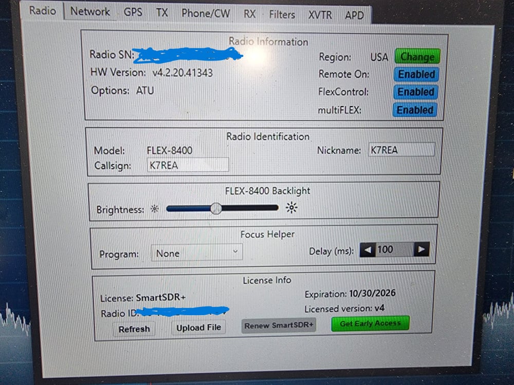

Well I've upgraded from
SmartSDR v4.2.18 to the new SmartSDR v4.2.20, did everything I was supposed to including a cold reboot - twice, rebooted the computer.

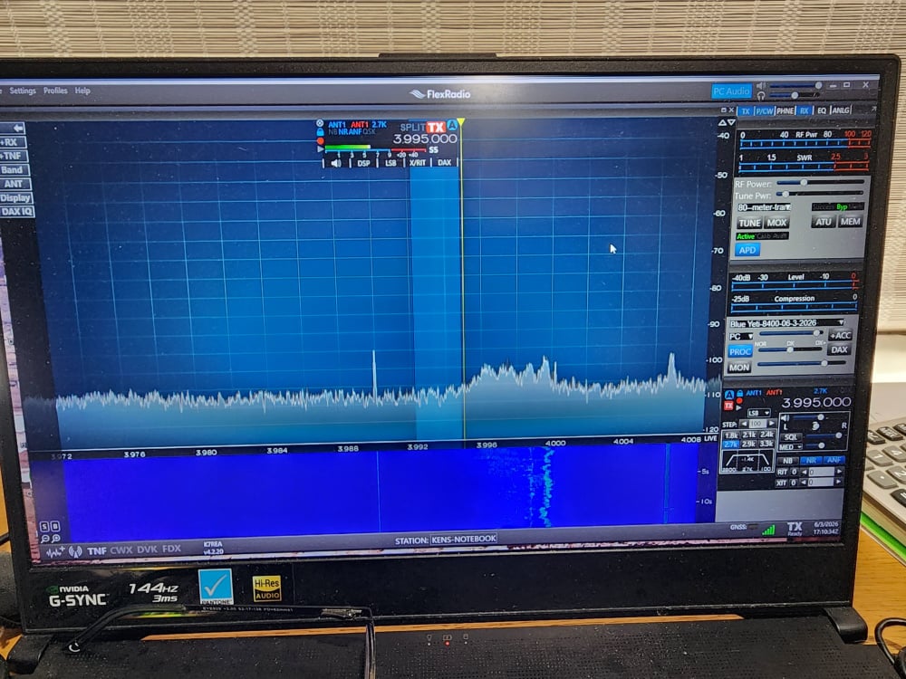

I do not see the new features, band edge, or noise filter goodies. What am I doing wrong? I shows the proper software version below and I even hit the refresh button. I do not see any changes this this version!
Hi Ken, did you purchase SmartSDR+?
If you purchased it, is your radio connected to the Internet? If not, you need to have it on a LAN segment that has Internet access. Once the license is verified, you can remove Internet access.
Yes the radio is connected to the internet.
Also this radio is a 8400.
Yes, back on 10/30/25 for Version 4

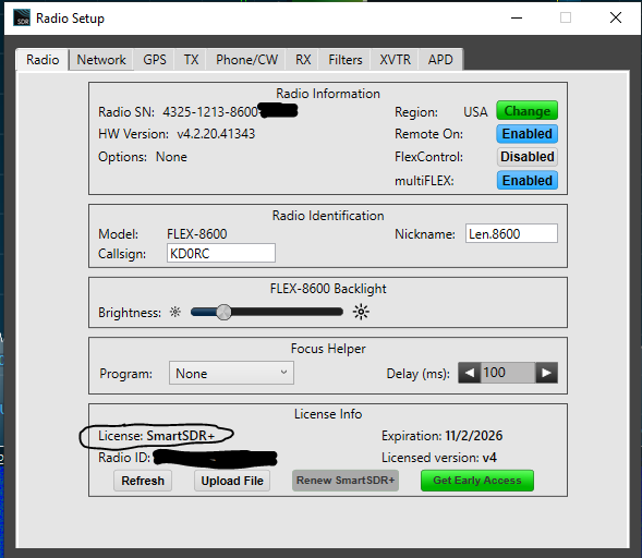

I don't see anything new either . Yes I have smartsdr+ I bought mine after Ken did.
It shows in radio setup.
My 6400 is also doing the same thing.
Click on the DISPLAY Tab on upper left, Scroll down to Band. Set it to your IARU region and then turn it on.
You will need to select and activate whichever other features you are interested in by visiting the appropriate area you are interested in. For example the Filters may now be customized by selecting SETTINGS at the top of SSDR and then select the RADIO Tab and then select the FILTERS Tab and there you can adjust those. and so on.

Ok - TNX! That is what I needed.
