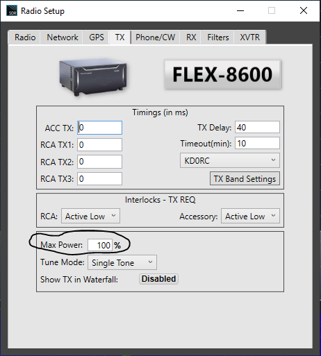

Hi Tom, make sure that Max Power is turned up:

I checked max power in TX settings and is 100% interestingly it remains 100% even if I change it to a lower value and open TX window again.
