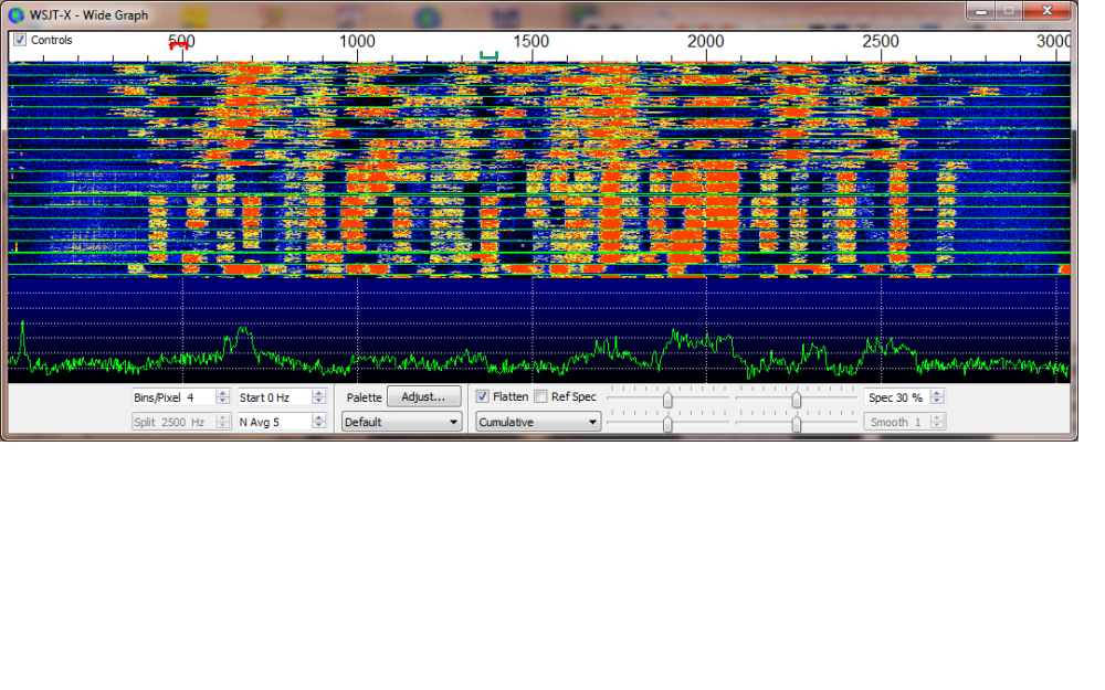

Here's a screenshot of WSJTX's waterfall showing what this issue does to received audio. The bottom of the waterfall is before the clicking started, and as you can see, the FT8 signals look clean and normal. The top of the waterfall is after the clicking starts, and you can see the signals are smeared out and undecodable.
