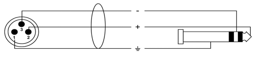

Hi,
As far as I can see, the microphone has a 3-pin XLR connector.You can probably find a cable from XLR to TRS 6.3 mm
at a music store.vy73 Klaus, DF3RP
