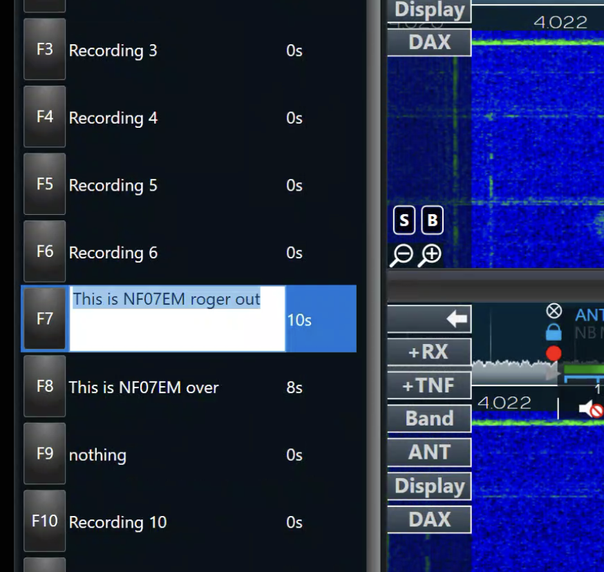

Second, I would like to rename each of the 12 messages to some other name, like CALLSIGN. Any suggestions as to how I can do this renaming or is it not possible at this time?

    1. If you have a laptop you probably need to press the FN to activate the real Function keys. F Keys works perfectly..
    2. Just click where it says recording #, and you can rename it.
  • Geoff AB6BT
    Geoff AB6BT Member ✭✭✭
    NF07EM?
  • Sorry but no. I’m not using a laptop. I know my keyboard function keys like F1 are working since they work in other programs, just not with DVK. Also, when I click on the recording # area, it won’t let me type in different verbiage. Thanks for your suggestions.

  • Thanks Geoff. I went back into DVK and did what you suggested. Amazing, everything is working now. Maybe you’re Santa and brought me an early Christmas present. I truly appreciate the help!!!!

    Gary…Glad to help when I can but it wasn't me!
