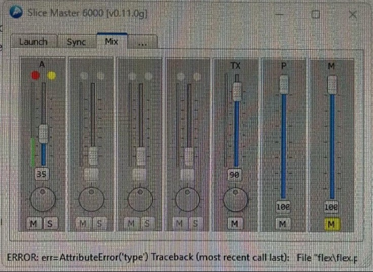

My computer performed its normal update last night and now I can no longer receive spots on SmartSDR. It is connected to the radio, just no spots…I am getting this error message:
Hi John, SliceMaster has not worked properly for the last few releases. I can get it to work with CW Skimmer by turning off the DAX IQ Streams at the bottom of the DAX panel, starting SliceMaster, then turning the IQ Streams back on.
I don't know if this will work for spots, but you might want to give it a try.
Thanks Len…just tried that…did not resolve it for me…
Yeah, it is probably only a workaround for CW Skimmer and maybe WSJT-X.
I use ACLog from N3FJP for my DX spots. There are a number of other sources including FRStack that you might want to try. I don't know if Don is planning on updating SliceMaster to work with Flex V4.
It was working fine with my V4 until my computer performed its driver updates…
