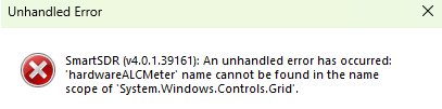

Receiving this error repeatably

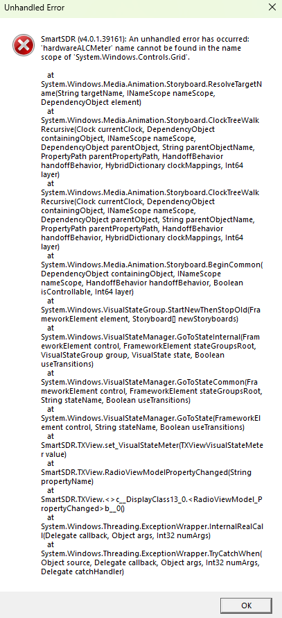

This exception is preventing me from using SmartSDR 4.0.1. SmartSDR crashes directly after this exception is displayed
Hi Doug, try a factory reset after exporting your profiles. I'm pretty sure that will fix it. If it doesn't, then submit a help desk ticket.
You might try a factory reset of the radio…
AL, K0VM
This suggests the error is software.
But if it's because of a corrupted data base leading to a software error, that is good info for the programmers to know. A factory reset clears the database. And it would get you back in business.
AL, K0VM
Al is correct. I had one today concerning CAT but I had been playing with ports so a radio reset cleared out the EXCEPTION.
Lar, K1UO
It is a software bug (SMART-11479) related to the Hardware ALC function. The factory reset would turn that off, which is why that bandaid likely has helped some.
If you are intending to use the Hardware ALC function, you may need to back down to v3.8 which didn't have this version or wait until a fix is available.
