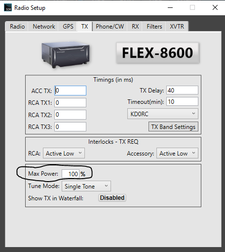

Hi Doug, it is likely the Max Power setting on the TX tab in Radio Setup:
That was it. I changed it, then attempted to increase the power, and the value snapped back to 10%. The second time I changed it, it stuck. Oddly, I never changed this value. I wasn't even aware of it. Before upgrading to 4.0.1, I had no trouble changing the power. Somehow in the update this value had been changed.
