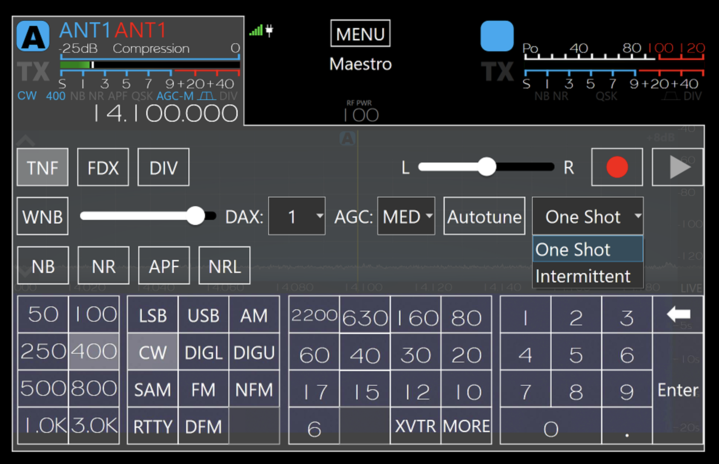

I have uploaded the new v 4.0.1 software and updated the maestro. How do I activate this feature? I don't see any menu item added on the Maestro Menue.
Gerry, W0GV
  • Eric-KE5DTO
    Eric-KE5DTO Administrator, FlexRadio Employee admin
    For Maestro, the AutoTune feature is in the Slice Menu on the top right side (in CW mode, of course):
